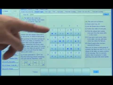

You didnât address usability and accessibility. Have you carried out user acceptance testing with a significant test group? If so how did they find the âwall of hieroglyphsââ user interface? How many different PINs could they memorise and successfully pick from the grid.
I agree partially with your statement when you said âNo security is going to stop the most determined hackerâ, traditional password system is like a regular glass, one shot the person behind the glass is dead, GATE is like a bulletproof glass, it can withstand multiple shots, by the time you realize someone is shooting at you multiple times, you could have got away [ changed your GATE passcode ], instead of staying there and being shot at. It greatly reduces the chance of being breached, and most hackers will go find some other easier targets.
You have to balance the risks of either side, by not storing the encrypted passcodes on the server-side, you have another set of problems âŚ
Your last question shows you havenât tried the GATE authentication system, once you learned how it works, itâs NOT as hard as it seems. For the hacker, yes, itâs hard, for the user, itâs easy to use and more importantly : secure.
Each dimension of symbols will have a fixed location on the token/button, 1st dimension has all the numbers, they will only appear on the upper left corner of each token/button, 2nd dimension has all the alphabets, they will only appear on the upper right corner of the tokens/buttons ⌠so on. Therefore if a user passcode is all numbers, the user only needs to concentrate on the upper left of each token to see if his pins are on the screen, and if his passcode are all characters like âpdacfâ, he needs to only look at the upper right corner of each token to locate his pins, they wonât appear in other 3 corners. This will help the user to quickly enter his passcode.
Iâve done some tests on my own, I can scan the table with my eyes and quickly locate the pins among other symbols, it only takes a second or so for each pin to be entered, you can verify that by looking at the videos I made, and if you donât want to take my word for it, just set up a camera and try it for your self, maybe you can do it even faster than me

I did. In your test with a real user he took around 12 seconds to enter a very simple 4 character PIN (card suits).
Now imagine you are using more complex 6 character PINs and have 10 different passcodes. Now imagine you have dyslexia or impaired vision.
A bio-metric based password manager meets all your questions and has the added security of a second factor and not storing whole passwords. Login is almost instant.
In my example it showed a 4 x 4 table, there are also 3 x 3 and 2 x 5 tables, they are more user friendly. Also in the video above it showed an old version of the UI, now there is newer version of UI, looks better.
