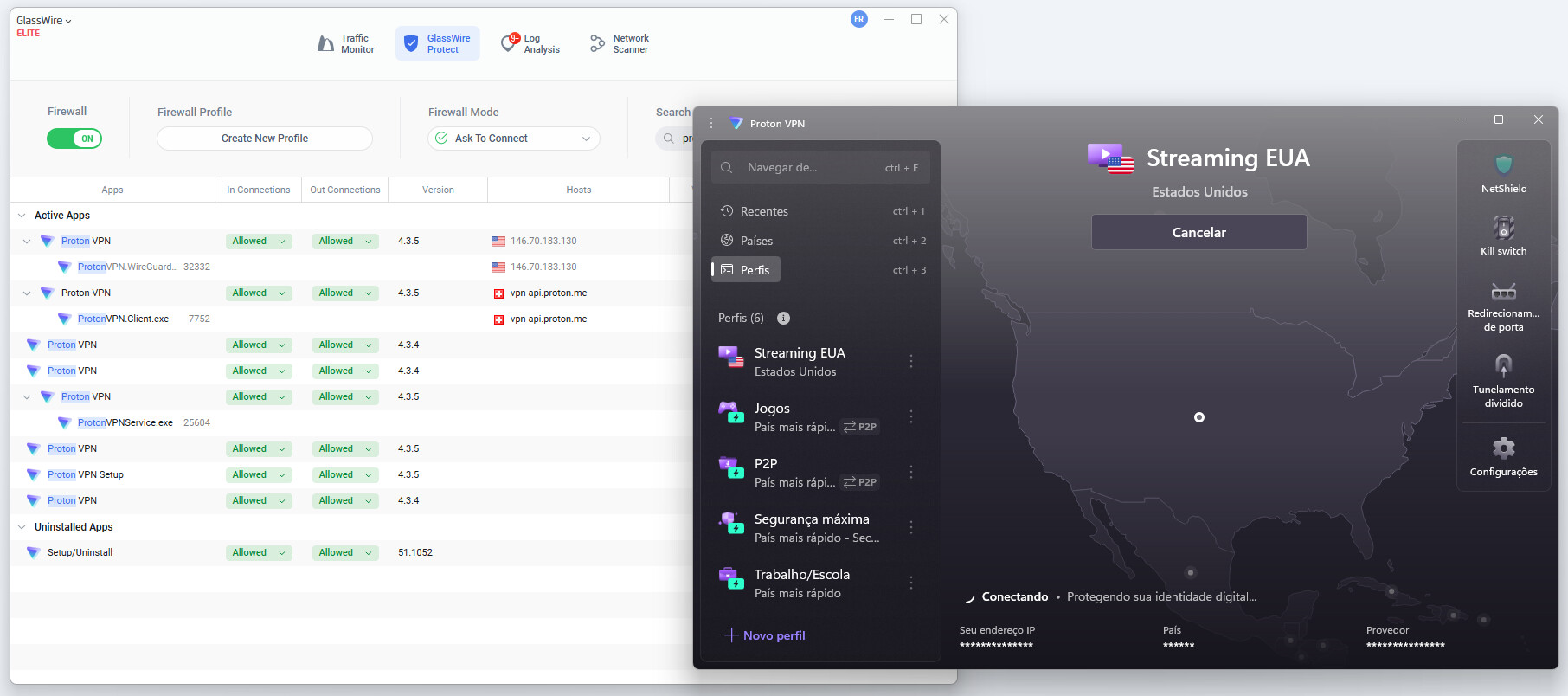

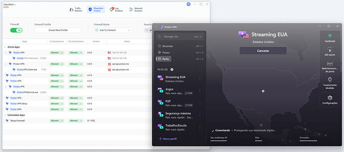

something similar happens when you try to connect through Proton VPN app
the Proton VPN app creates a new app instance for every connection and by default it’s been blocked. glasswire doesn’t even offer that popup to allow or not. I thought it was a Proton issue, but evaluating Glasswire behavior inside app I found that ProtonVPN instances being created, trying to connect, but blocked.
a nightmare… i try to monitor proton while trying to connect to leave everything always green. but it’s not a permanent solution.

While GlassWire currently can’t recognize the app, it seems to be only because it is running from a different location on the partition. A partial solution would be for GlassWire to take a hash of the file when it is allowed and automatically allow any program with the same hash in the future.
