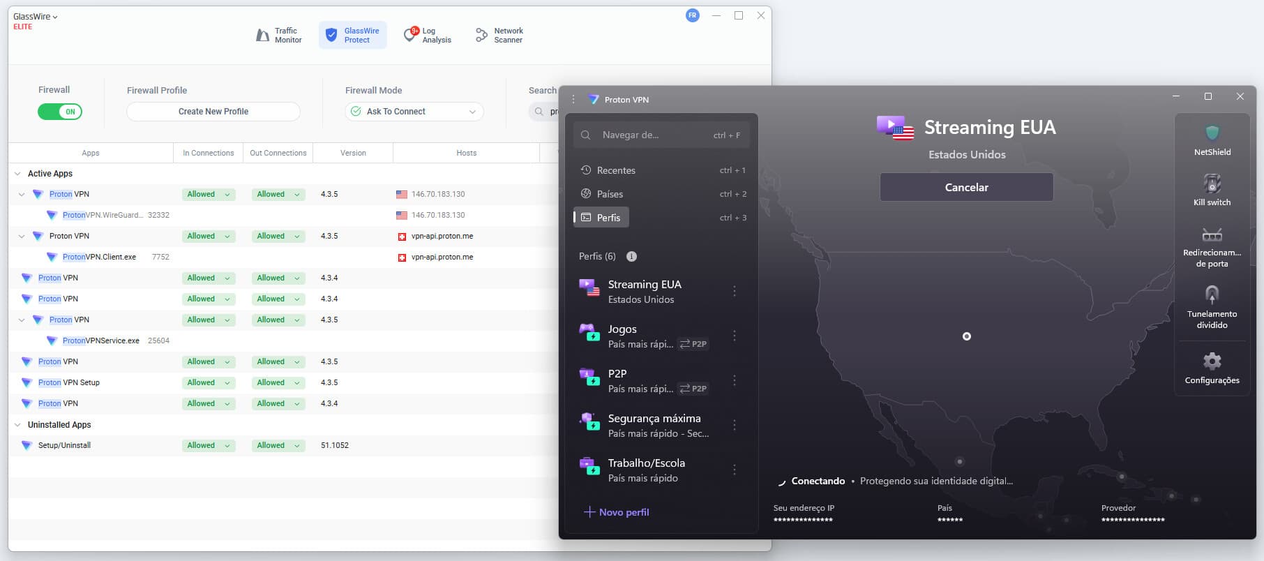

same here.
the Proton VPN app creates a new app instance for every connection and by default it’s been blocked. glasswire doesn’t even offer that popup to allow or not. I thought it was a Proton issue, but evaluating Glasswire behavior inside app I found that ProtonVPN instances being created, trying to connect, but blocked.
a nightmare… i try to monitor proton while trying to connect to leave everything always green. but it’s not a permanent solution.
The path is probably different and incorporates a unique identifier for the current session/connection. You can check the path by clicking on the entry. If this is the case, GlassWire does not have the ability to recognise the app.
