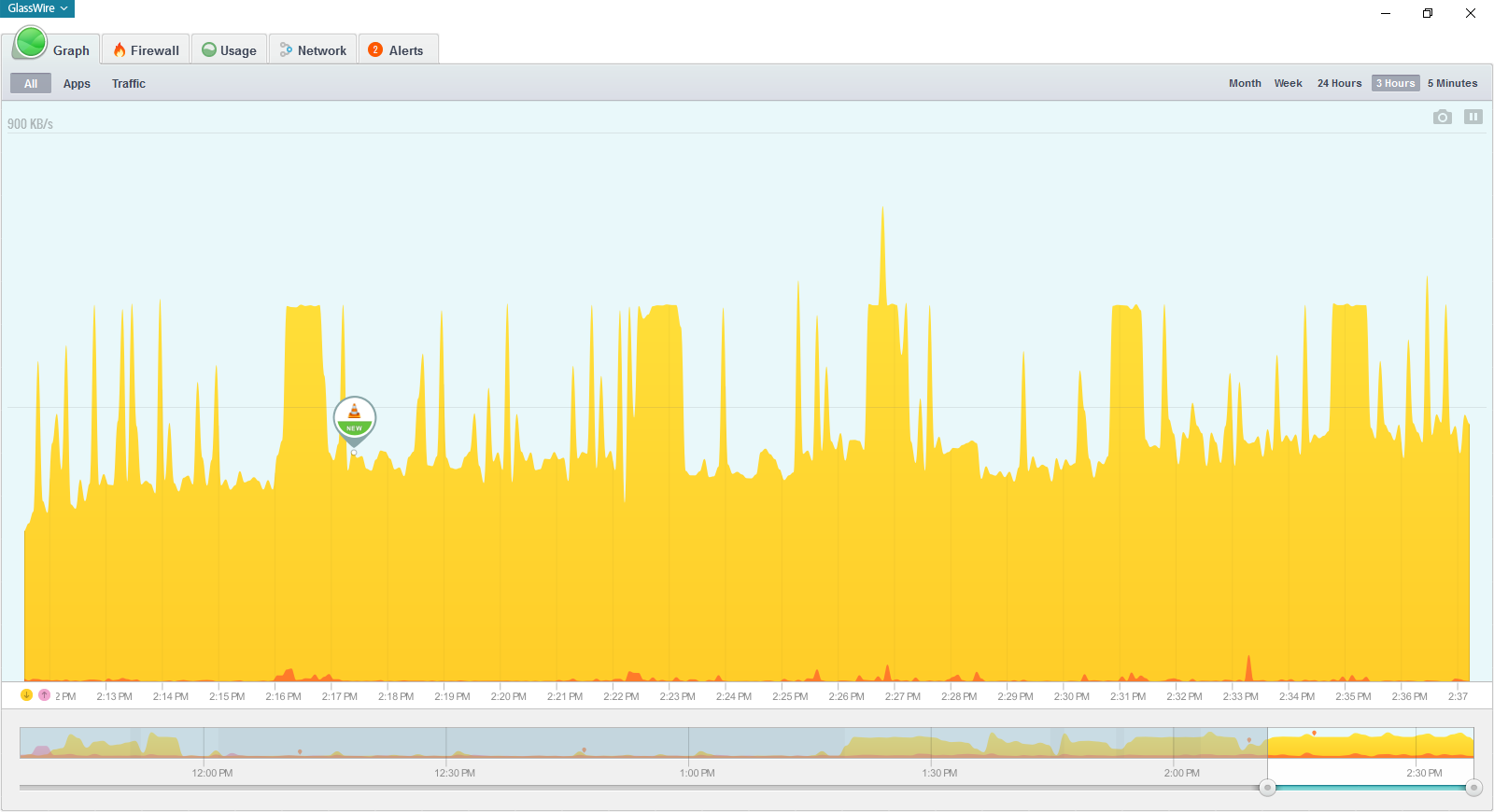

I noticed that the scaling of the bandwidth graph is off when the scaling switches from KB/s to MB/s due to changing the shown interval.
In the screenshots you can see roughly the same interval. The scale on the KB/s graph looks plausible to me matching my 6 Mbps connection speed.
When the scale switched over to MB/s the smoothing looks good, but the scale doesn’t match. As you can see the maximum peak in the middle changed from about 700 KB/s in the first image to about 18 MB/s in the second image.
Or am I misinterpreting the graph?

Thanks for reporting this. We’ll try to recreate this on our end and see what’s going on. Looks like VLC?
Thanks for your response. Yes, that was VLC first time connecting to the update server.
We confirm this is a bug. We’re working on a fix. Thanks for your report.
