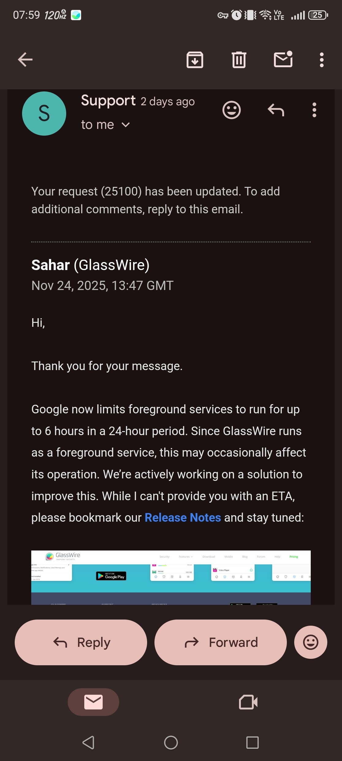

This is the response I got back from support regarding the error.
Seems like android has a known problem for now.
Interesting. Thanks for letting me know. I’m surprised more people have not chimed in with a “Me, too”.
