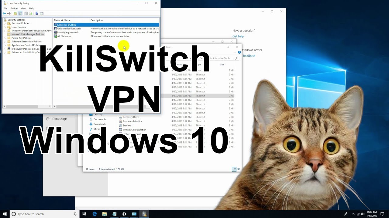

I’ve always followed this tutorial in order to create a killswitch to windows10 VPN, just for you to know.
I’m trying this one also with no success…

this may be the real solution for this situation.
it works perfectly while not installing glasswire.
unfortunately, immediately after installing glasswire, it stops working. reseting or not Windows Firewall policies.
if some support technician could help me to tweak this tutorial to use together with glasswire, all the time lost trying to solve it would be worth.
