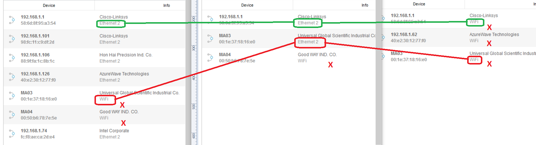

I’d like to know what your polling plan is – now and for the future. What I mean is, just ast Ramah sees either “mixed” or “left over” information, I (with 1.2.68) am seeing previous information or “mixed” (info for one connection showing in another – perhaps swapped or just lifted or “drifted” over to another connection. I’ve even seen the Label that I put on one device, associated with another and then changed back again some time later. This isn’t real occasional, it is pretty much the norm in the short time I’ve had 1.2.68. So I’d like to know how you are polling (what schedule, what process, are you storing/retrieving the information, what to expect as I’m waiting for these issues to resolve within this and future test and public releases.
Here’s an example showing the difference after I restarted my system twice today:
The red X’s indicate incorrect interface details.
The green connected lines show the router details which incorrectly changed to WiFi when it should be Ethernet 2.
The red connected lines show the MA03 computer I used in the bug report above. The interface is incorrectly WiFi when it should be Ethernet 2.
