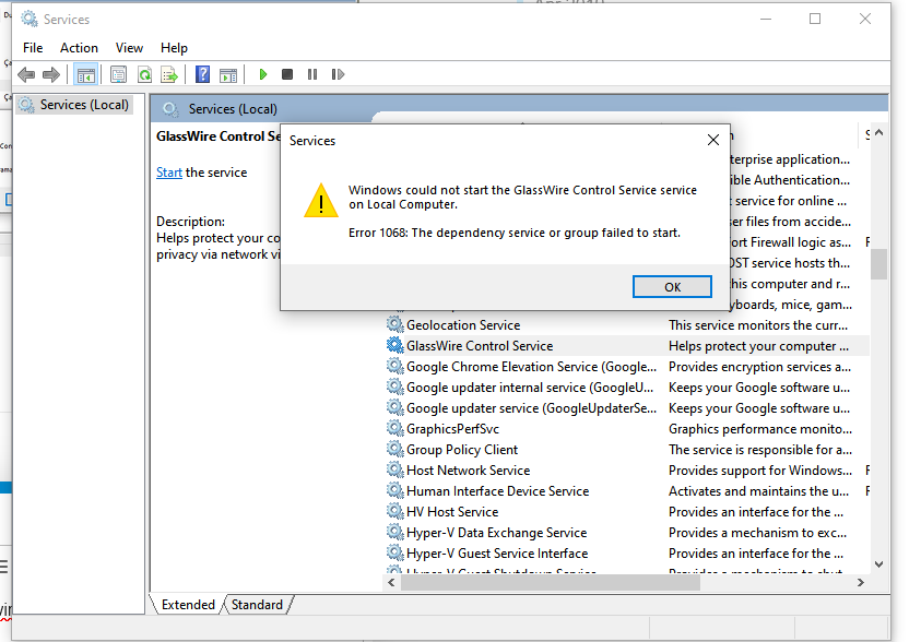

first GlassWire service does not work
I start GlassWire service but gives an error message
error : 1068
@osmandemi
Sorry! What is it in English? Can you give a rough translation?
Also did the log instructions above work? We need the logs to find the cause of the issue.
english :
error 1068 : the dependency service or group failed to start
Is the base filtering engine service running?
yes it is work no problem
