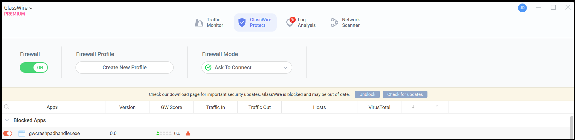

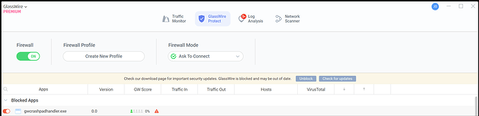

This morning I woke up to Glasswire being closed again. So I opened it and this error message was at the top of the screen. I can confirm that I indeed have the latest version of Glasswire. It looks like Glasswire blocked itself either right before it crashed or when I reopened it. Once I allowed gwcrashpadhandler.exe the error message across the top disappeared. Roughly 30 minutes later Glasswire disappeared from my taskbar again.
This is just one of many of the random issues that keep occurring.
