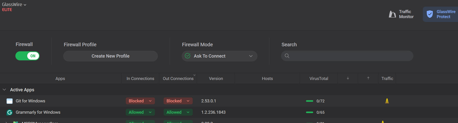

I spoke too soon. With 3.8, I just noticed “Git for Windows” is blocked for both inbound and outbound. I did not notice any “Ask to connect” pop-ups from GlassWire related to “Git for Windows” and certainly did not explicitly say I wanted it blocked.
So a major complaint about 3.7.880 is STILL NOT RESOLVED. Over 6 months after being reported.
Not a good sign…
“When you are getting a headache from banging your head against the wall, the sane person stops banging their head against the wall.”

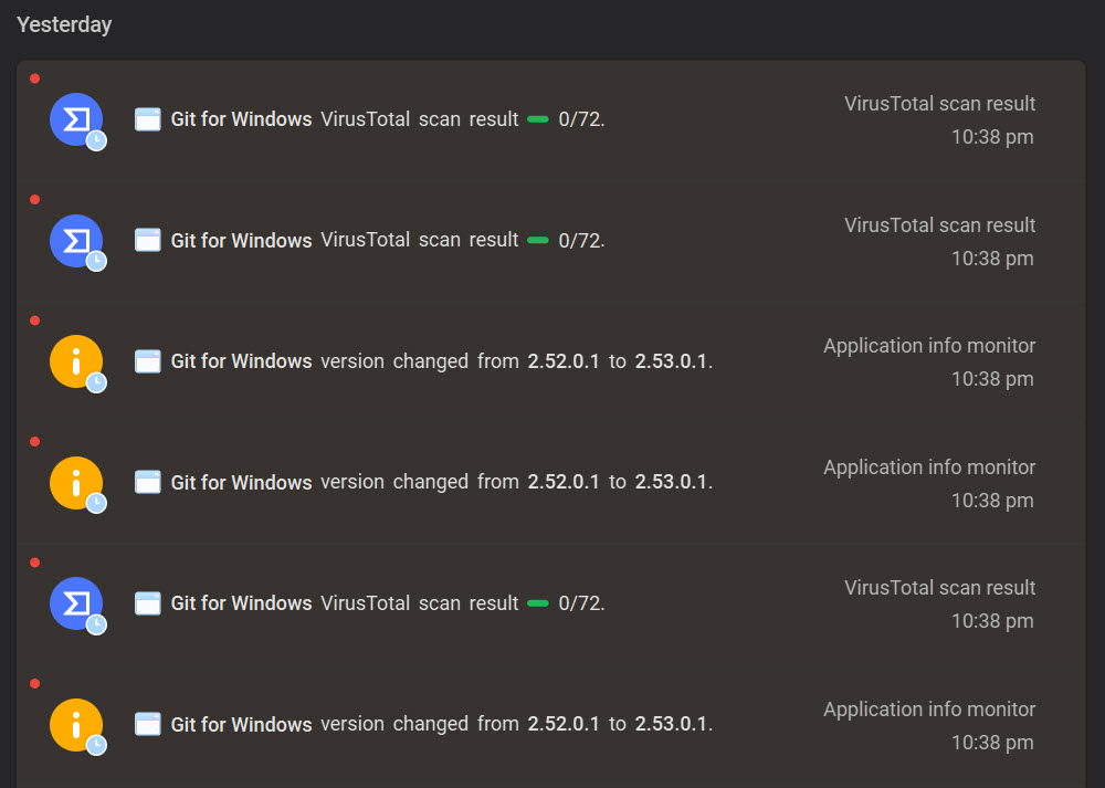

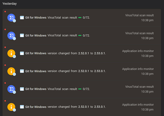

Attaching a screenshot of the log analysis tab (and the “Protect” tab). I know for certain that “Git for Windows” was not blocked by GlassWire prior to “upgrading” to v3.8. I specifically checked the GlassWire Protect tab just prior o going to v3.8 and nothing was blocked for outbound.
I have no clue why the logs show an identical version change 3 times, along with 3 scan results from VirusTotal.

Okay, I am still banging my head against the wall. And GlassWire is still seriously broken. Using in “Ask to connect” and with VirusTotal. GlassWire 3.8.1030.

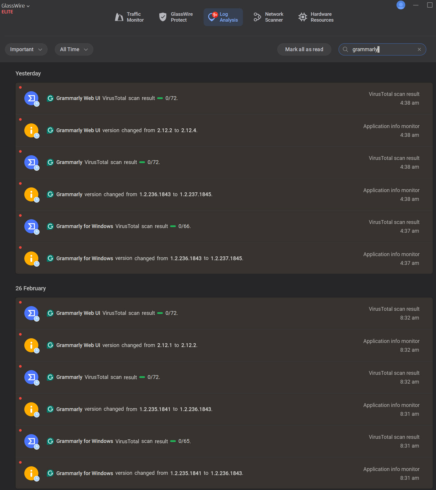

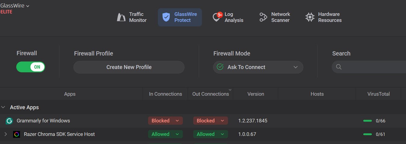

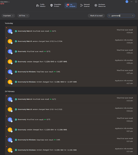

Today, I discovered Grammarly for Windows was blocked. I didn’t specifically block it.
Screenshots showing GlassWire Protect tab and the Log Analysis tab filtered on “Grammarly” with log activity in the last few days.

From your logs it looks like both Git for Windows and Grammarly are showing newer versions. When an app updates, GlassWire currently treats the new version as a separate entry, so the rule from the previous version doesn’t automatically carry over.
That said, you should still normally see an Ask to Connect prompt when the new version first tries to connect.

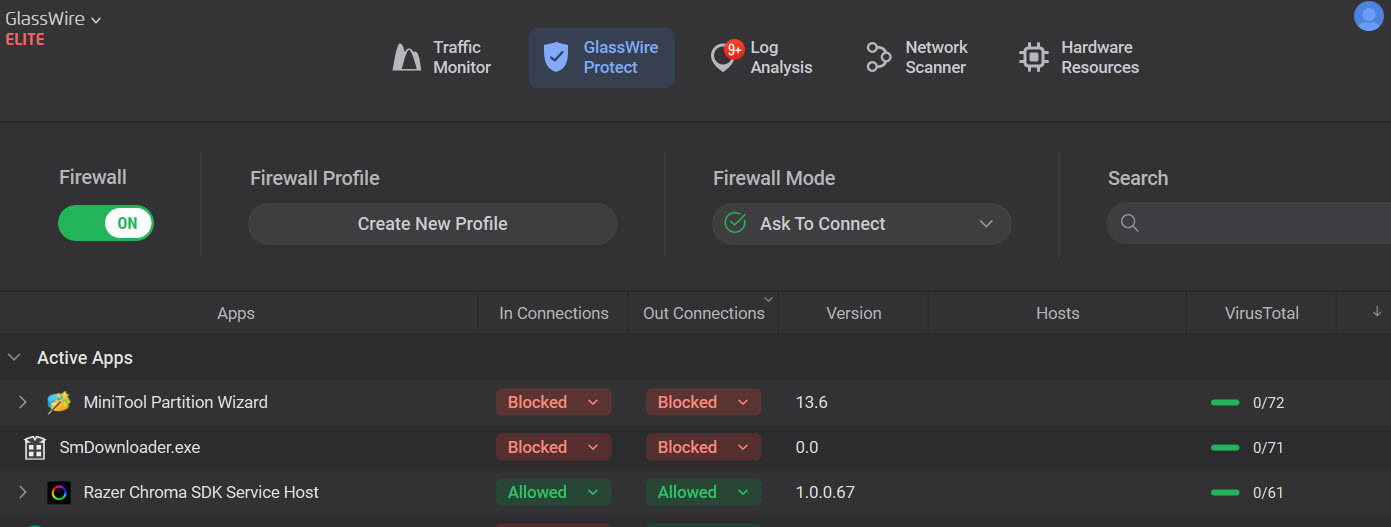

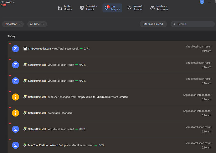

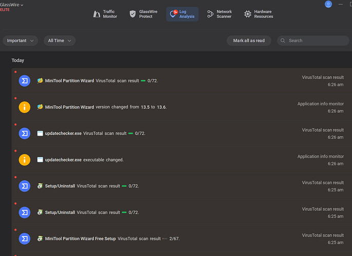

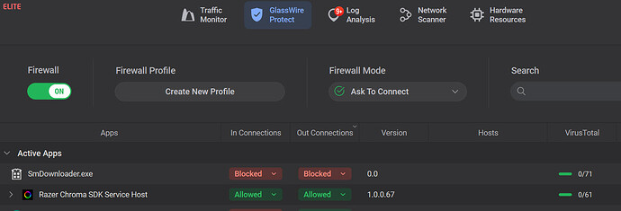

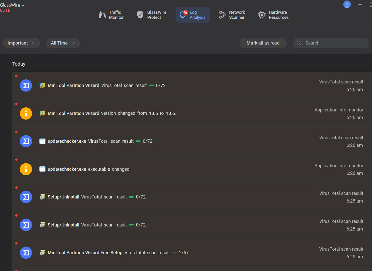

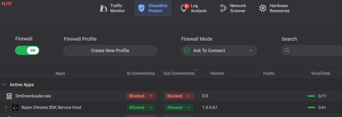

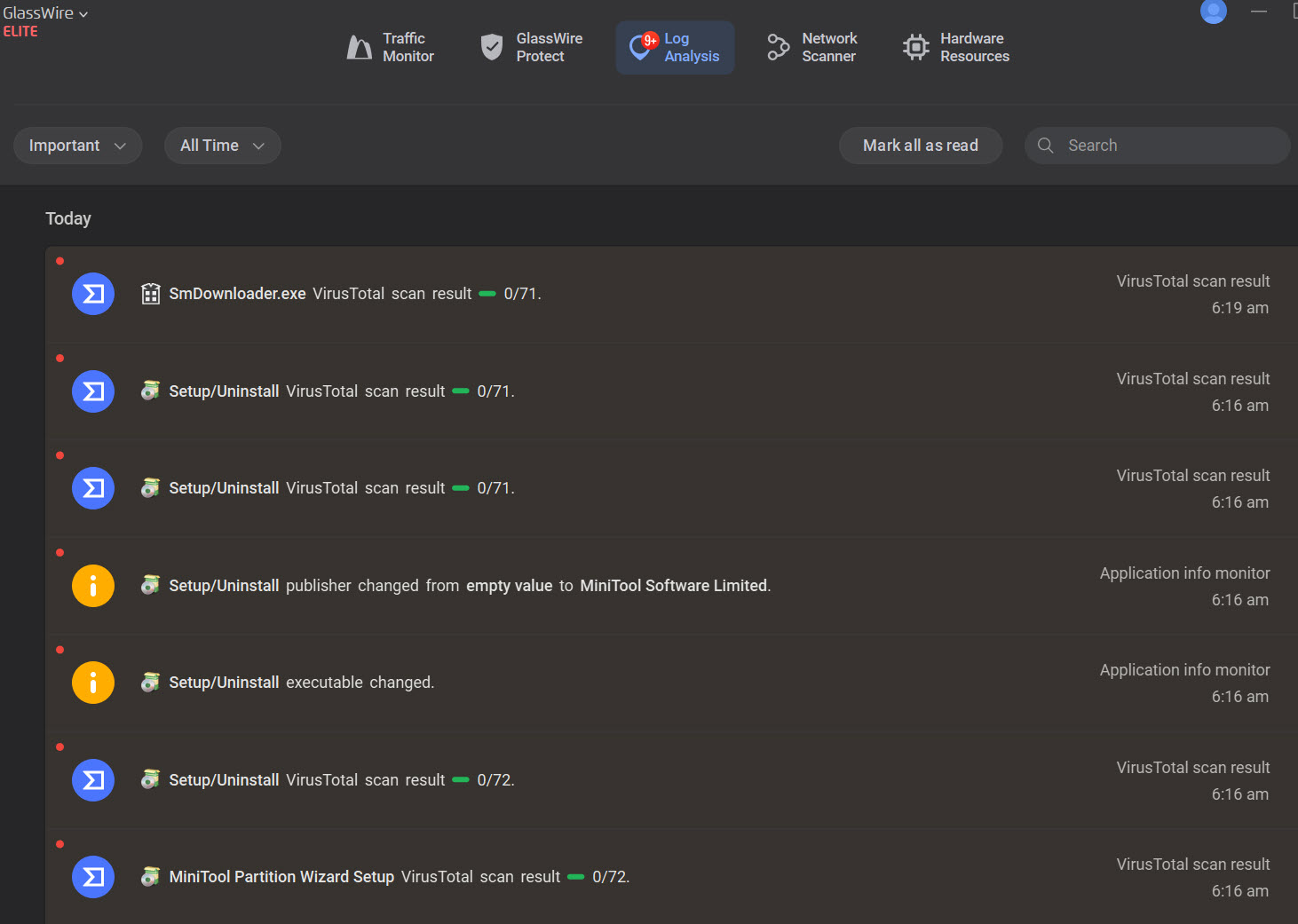

This is getting really old. It happened again. This morning I got a prompt from Minitool Partition Wizard saying an update was available. I clicked to upgrade it. It failed. I checked GlassWire and it blocked smdownloader.exe (see screenshot of Protect tab and Log Analysis tabs. I defintiely did not get any pop-up from GlassWire asking if I wanted to allow it.
Ongoing saga. Following the advice from Minitool that if the installation of the update failed to download the stand-alone installer. I did that and “Minitool Partition Wizard” was blocked. I did not get any pop-up from GlassWire asking for permission.
@CTaylor That’s super frustrating. I appreciate you sending all these details and screenshots over. I’m passing this info along to our development team to investigate. Feel free to continue sharing any additional detail or unexpected behavior you run into.

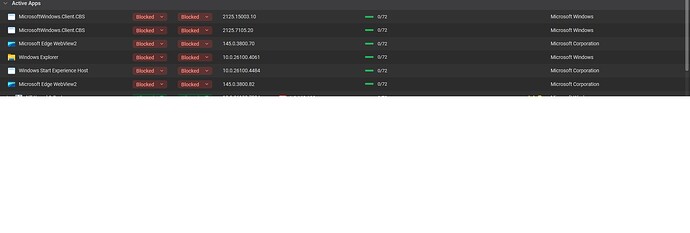

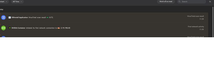

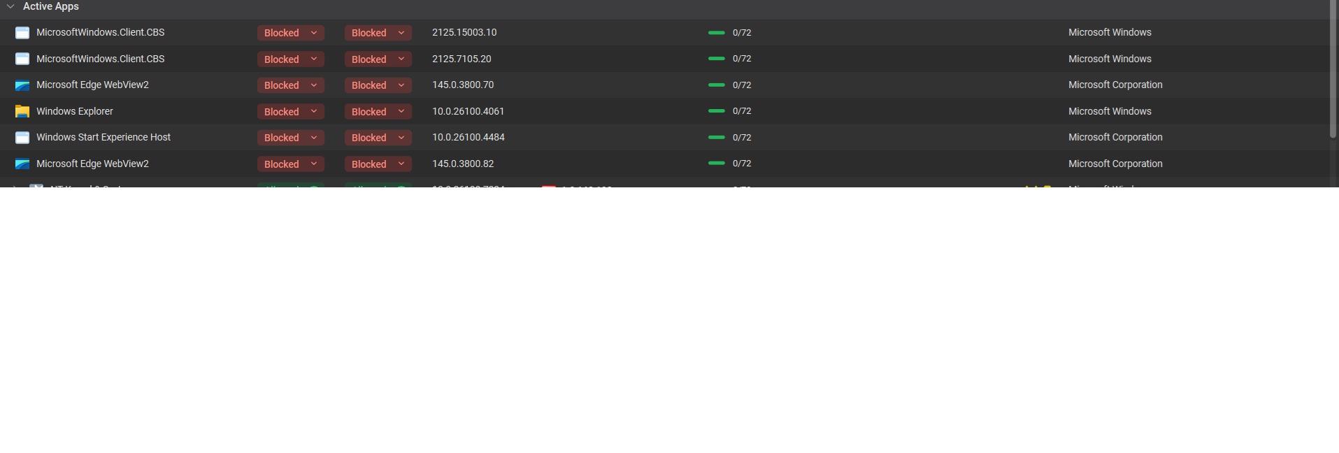

Just tested the new 3.8.1033 on Win 11 Pro 25H2.

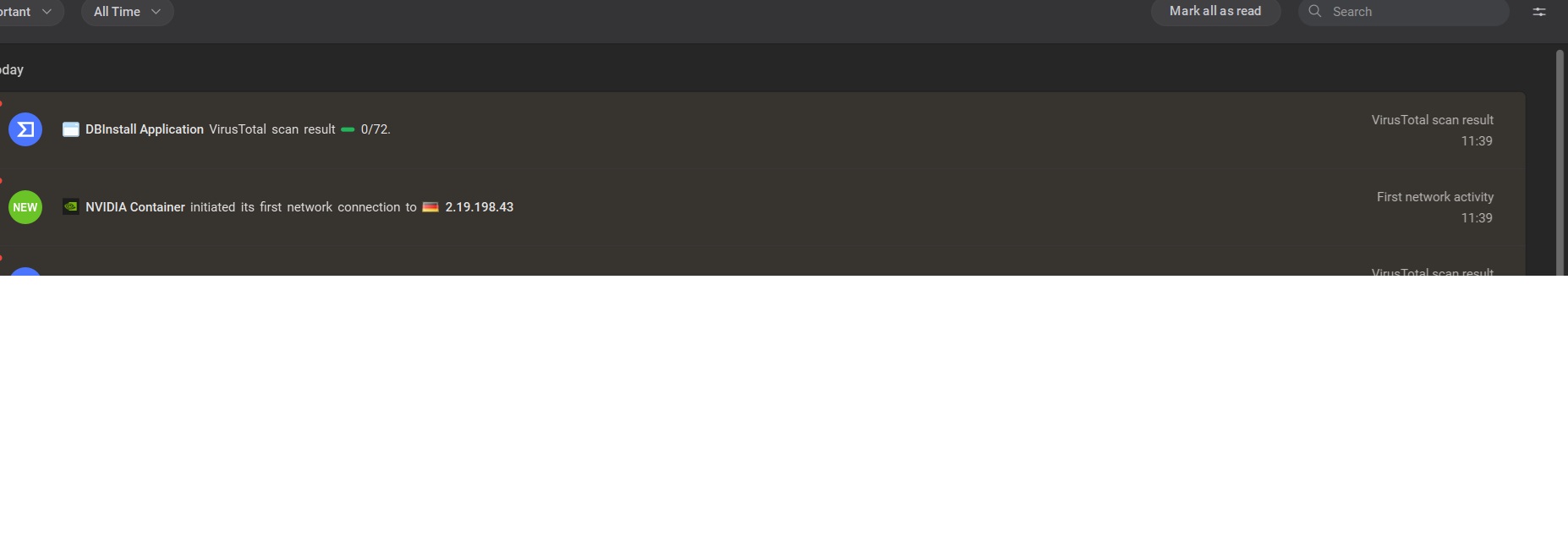

I did an over the top install without changing any default checkboxes in the installer. Then I rebooted the pc. Glasswire lost some of my blocked items in the new version e.g. Nvidia container
At some point later GW asked to allow block Nvidia container (a file that afik never changed between install at all).

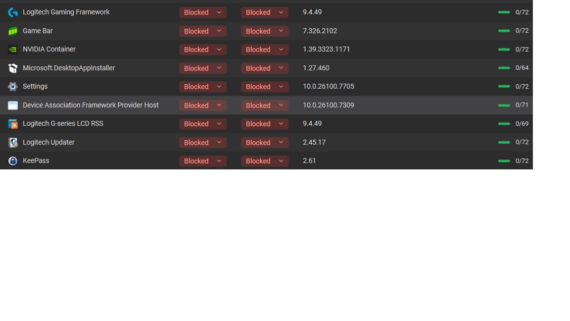

Older GW version blocks

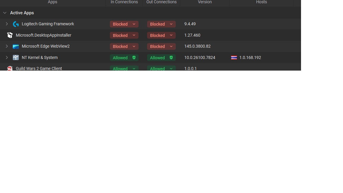

After updating GW to new version:
As you can see GW now has way less blocks shown. Keepass and Nvidia Container are missing and so on.
wow I just checked back to see if they fixed .. looks like still some issues ongoing.
