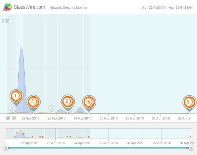

It turns out that the Graph is affected as well. The slow updating of the Graphs meant that I didn’t notice it last night.
This looks similar to an unresolved issue I reported in the past. That problem also occurred after I had also been doing a lot of different things in GlassWire:
I’m going to restart my system and see if the data is also lost this time.
Yes, GlassWire had stopped logging data just like the unresolved problem with 1.2.57b.
Restarting Windows restarted the logging.
Do you get this problem only once or every midnight?
The problem occurred before midnight, as you can see on the graph, so I don’t think that is related.
Initially, I was reminded of past problems that I had also had with having the GlassWire window open at midnight:
The other time that GlassWire stopped logging data was on an earlier test version, 1.2.57b. The only common thread I have noticed is that the data logging stops after I spend a couple of hours working in the GlassWire window. But it doesn’t stop while I am actually viewing GlassWire:

The problem has happened again. Coincidentally at about the same time at night:
This time I cannot see when the time when it stopped logging data as clicking on he graph has left it stuck “Loading data”.
Last time this happened, I had GlassWire problems on my other PC. This has happened again:
FYI, I haven’t got the logging version of GlassWire from your helpdesk as @Servo_GlassWire suggested because I’ve taken a break from bug finding.
This time my other computer has stopped logging about 6-7 hours later:
